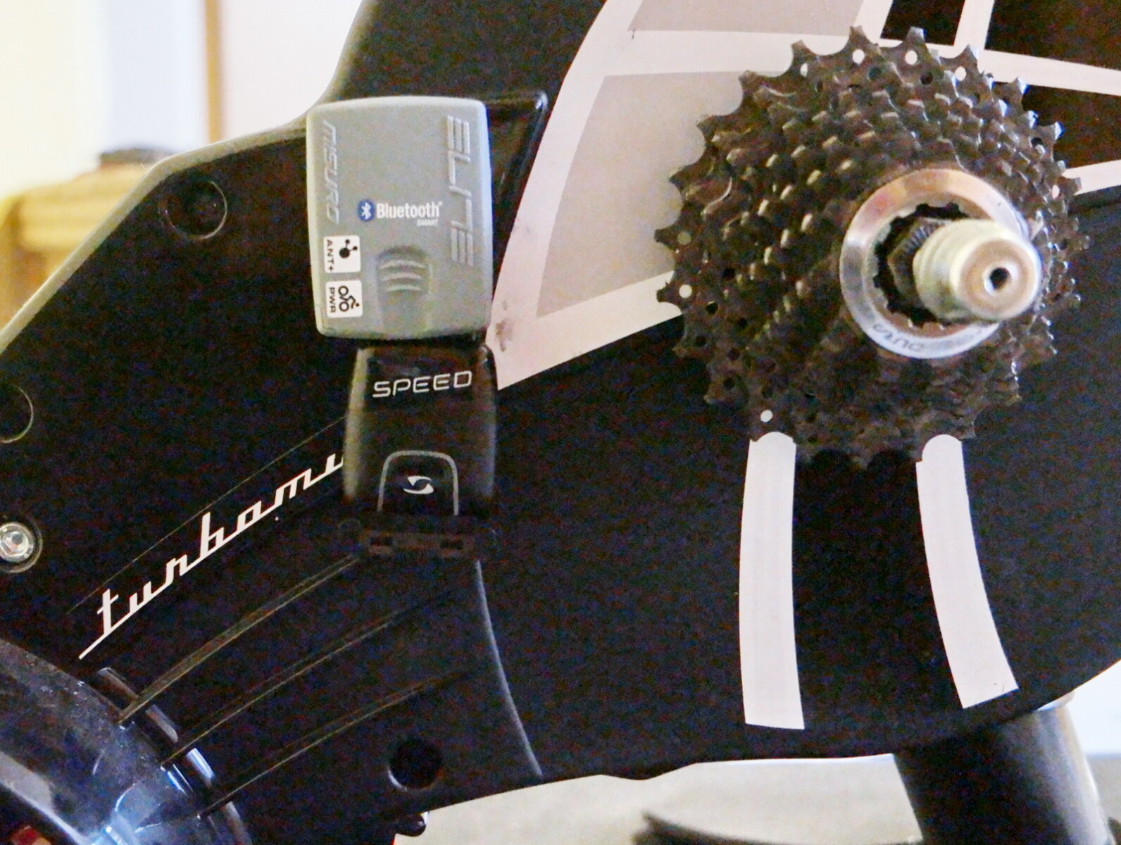

Kupiłem standardową wersję elite turbo muin na rok 2016, przymierzam się do zakupu czujnika elite misuro B+ (czujnik kadencji i prędkości) http://www.elite-it....misuro-blu-plus,
Próbowałem jakość sparować prędkość z czujnikiem garmina GSC10 niestety bez efektu:((
Czy przy zakupie dedykowanego czujnika elite będzie możliwość sparowania z urządzeniem Garmin 500 Edge?!!!

Do PC i Bushido wystarczy ANT Stick, nawet taki COOSPO USB ANT Stick Dongle Forerunner 310XT 405 405CX 410 60 610 910 za nieco ponad 5 dych (z przesyłką, coć z miesiąc trzeba czekać).
Ten brak nadawania ANT+ w Elite jest strzałem w kolano...
Ale w/w linku do dcraimakera możesz poczytać komentarz:
Henry
1363359-400x300.jpg?1446799290
When overflying your replys for me seems to be a misunderstood of the Elite MISURO B+ modul.
Pimping a simple Elite trainer like the TurboMuin with the optional Misuro Smart B+ modul delivers ANT+ and BT for your device (FEC compatible, smartphone or PC) and it works without any problems!
I’m using the modul with a Elite TurboMuin in connection with Edge 1K and GoldenCheetah (via ANT+ USB 2.0 Stick).
Problem if using a TM with Serial <30000 you will get speed and power but no cadence. Cadence from the Garmin sensor does not work, because the Misuro B+ acts like a GSC10 combined sensor from Garmin.
Means you have to decide what to receive with your device: power and speed (only Misuro) or power and cadence (Misuro + Garmin sensor).
The lost of speed should be no problem, it's for training not realy necessary. If somebody with an old TM needs it anyway the solution is a simple ANT+ speedsensor, mounted below the Misuro B+. Via ANT+ you will receive power from the Misuro, Cad from the Garmin sensor and speed (and as a result out of that the distance) from the speed sensor (see the picture).
Acuracy of the MISURO B+ sensor in power I'm still testing in comparising with a ROTOR InPower Wattmeter. The results will be seen on my homepage at the end of november (sorry, site is in german).
Tak więc jak widać na załączonym obrazku (i tekście), Misuro z nr seryjnym do 30000 będzie się gryzł z GSC-10 i trzeba się zdecydować praktycznie na jedną opcję: moc i prędkość z Misuro lub moc i kadencję (z czujnika garmina) - choć szczerze mówiąc jestem ciekaw jak to będzie działać z osobnym czujnikiem kadencji? Swoją drogą rejestracja prędkości na trenażerze jest bez sensu, powtarzam już to po raz kolejny, no chyba, że do kalkulacji mocy wirtualnej, ale właśnie to robi Misuro.  Kombinacja jak na w/w obrazku - czyli dodatkowy czujnik prędkości jest trochę bez sensu...
Ale zgodnie z instrukcją w/w problem jest tylko dla turbo młynka do nr seryjnego 30000, późniejsze transmitują już moc, prędkość i kadencję.
